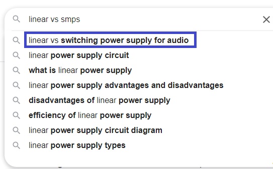

1 oră în urmă, Danut Marinescu a spus:
Am bintuit pe net
Asta parea mai interesant.
EDIT: ce zic unii

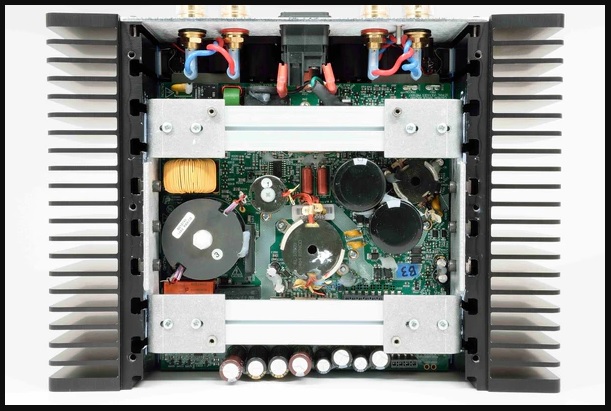

The AHB2 is a linear power amplifier with switch-mode power supplies. To the best of our knowledge, it has the highest SNR of any audio power amplifier. The A-weighted  SNR is 132 dB in stereo mode and 135 dB in mono mode. This is 15 to 30 dB better than most of the best power amplifiers. This low-noise performance would not have been possible with a linear power supply. A linear power supply would have created strong line-frequency magnetic fields that would have created low-level line-related hum and buzz. This magnetically-induced line-related interference limits the noise performance of most power amplifiers. Please note that magnetic interference is radiated not conducted. This means that is cannot be removed with filter capacitors. Adding filters to a linear supply will not remove the hum and buzz from a power amplifier.
In the AHB2, the magnetic components (transformers and coils) are fully enclosed in ferrite pot cores. These are the grey cylindrical objects (with wires) shown in the photo above. These high-power magnetic devices are very small because of the high operating frequency. The magnetic field strength is correspondingly small and is well above audio frequencies. The small size also makes it possible to build the magnetic devices inside of ferrite pot cores. These ferrite cores fully encapsulate the coils and greatly reduce stray magnetic fields.
The AHB2 uses a resonant switching design and this greatly reduces the switching noise. The switching transistors are mounted to aluminum bars that transmit the heat to the outer heat sinks.
