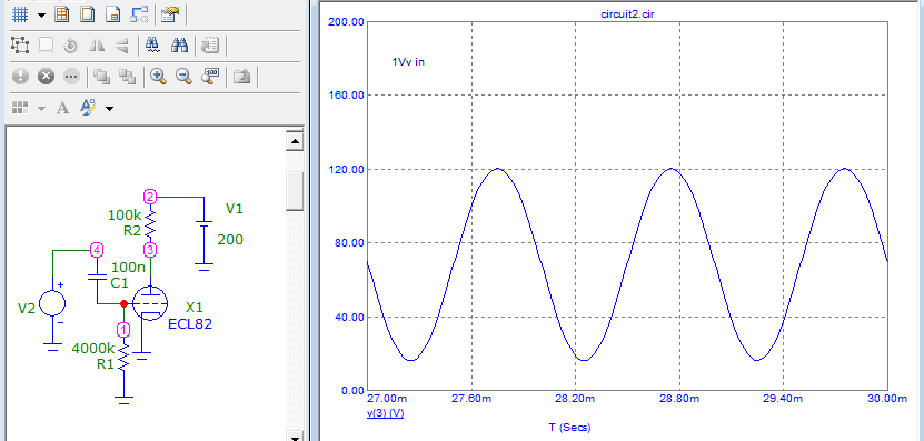

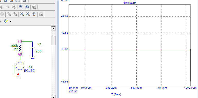

merck Postat Iulie 24, 2024 Partajează Postat Iulie 24, 2024 La 23.07.2024 la 22:18, yo9hrb a spus: Intrebarea mea este: cum mama naibii se polarizeaza grila triodei, avand in vedere ca și catodul este legat la masa? Grid Leak Biasing A method for biasing (mainly high mu triodes or small signal pentodes) that used to be common is 'grid leak' or 'contact' (aka 'contact potential') biasing. It was common in early radio receivers when valves had directly heated cathodes (filaments), so cathode biasing couldn't be used. Using grid leak bias eliminated the need for the 'C' battery, which supplied a negative voltage to bias the valves in the receiver. By using a very high value grid resistor and a coupling capacitor from the previous stage, stray electrons from the space charge surrounding the cathode are collected by the grid, and cause a voltage to appear across the grid resistor. This is also combined with the different 'work functions' ¹ of the cathode and grid materials. The grid resistor will generally be well over 1MΩ, and up to 10MΩ may be used. For example, if the grid collects (say) -100nA (nano amps) of current, a 10MΩ resistor will cause the grid to be at -1V referred to the cathode. With normal cathode bias, the grid can be direct coupled to the outside world unless there are DC voltages present, but when grid leak bias is used there must be a blocking capacitor. This is because the grid will be at a negative voltage referred to the system ground, and any external connection would bridge the grid leak resistor and affect the valve's operating point. The coupling capacitor also stores the average voltage generated by the grid current. In general, grid leak biasing is rather unpredictable, and is easily disturbed by a high level input signal. This can cause the valve to 'block' - basically switching off and preventing amplification until the grid capacitor has discharged back to normal. The blocking action happens when the input signal forces the grid to a positive voltage, and causes diode action between the cathode and grid to charge the input capacitor to the point where the valve is forced into cutoff (see note below). C- este bateria Link spre comentariu

merck Postat Iulie 25, 2024 Partajează Postat Iulie 25, 2024 Un condensator odata cu cresterea frecventei ii scade impedanta, ceea ce se traduce ca la joase vom avea o atenuare. La amplificatoarele pe tuburi deja traful de iesire este deficitar la joase, daca mai adaugi si un condensator vei avea o atenuare si mai mare pe joase si la pachet mai ai si o schimbare de faza. Alt motiv este pastrarea reactiei in catod (daca pui condensator se anuleaza reactia locala din catod => cresc distorsiunile). Citat You get first-order roll-off below a corner frequency fc = (gm + 1/R)/(2πC), where gm is the transconductance of the valve - sum of the transconductances to the anode and to the screen grid if it is a pentode. So it's not just the cathode resistor that matters, but also (and usually mainly) the transconductance. This follows from network analysis, where I neglected the valve's internal resistance for simplicity. Turning the equation inside out, C = (gm + 1/R)/(2πfc) You usually want fc to be far (two octaves or more) below the audio band, because you already get some roll-off and phase shift at frequencies above fc. When C approaches infinity, the roll-off and phase shift at audio frequencies approach zero, but the time the voltage needs to settle at power-up approaches infinity. Depending on the rest of the circuit, you may also get a nasty current peak through the valve. I wouldn't make the time constant RC more than a second or so, short compared to the time that the valve needs to heat up. Link spre comentariu
merck Postat Iulie 25, 2024 Partajează Postat Iulie 25, 2024 Cineva a masurat distorsiunile la 1 W (fara condensator amplitudinea semnalului in grila fiind mai mare): I don't have a PP amp on the bench, however for the SE amp I currently have on the bench at one watt out shows: Configuration V-G rms THD at 8 ohm resistor output No Bypass 48.8 0.730% With Bypass 19.2 1.849% Link spre comentariu
