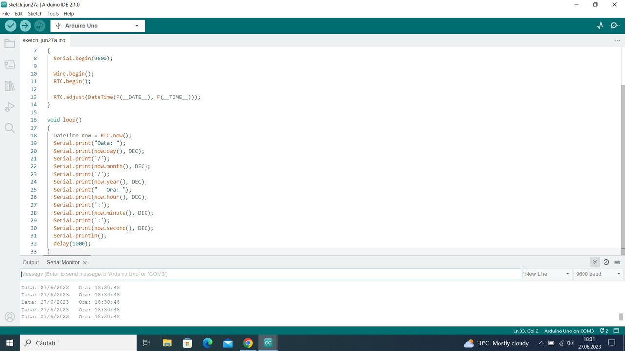

daniels Postat Iunie 27, 2023 Partajează Postat Iunie 27, 2023 Am facut acest proiect, https://www-instructables-com.cdn.ampproject.org/v/s/www.instructables.com/4-digit-7-segment-Led-Clock-With-Manual-Adjust-Ala/?amp_gsa=1&_js_v=a9&_page=true&usqp=mq331AQIUAKwASCAAgM%3D#amp_tf=De la %1%24s&aoh=16876247897520&referrer=https%3A%2F%2Fwww.google.com&share=https%3A%2F%2Fwww.instructables.com%2F4-digit-7-segment-Led-Clock-With-Manual-Adjust-Ala%2F Am o problema cu modulul RTC DS1307 in sensul ca afiseaza o ora, dupa care nu se mai schimba nimic. Temperatura si umiditatea sunt afisate corect. Schita folosita este /* base sketch: https://cdn.sparkfun.com/datasheets/Components/LED/_7Seg_Example.pde 4 digit 7 segment display: http://www.sparkfun.com/products/9483 7 segments + 4 digits + 1 colon = 12 pins required for full control modified connexion by Nicu FLORICA (niq_ro) from http://nicuflorica.blogspot.com http://arduinotehniq.blogspot.com http://www.tehnic.go.ro http://www.arduinotehniq.com/ ver.4.5 - change for manual adjust for hours and minutes, thermometer and higrometer: 11.08.2017, Craiova ver.4.6 - show the alarm time when push + button */ int digit1 = 11; //PWM pin for control digit 1 (left side) int digit2 = 10; //PWM pin for control digit 2 int digit3 = 9; //PWM pin for control digit 3 int digit4 = 6; //PWM pin for control digit 4 (right side) int segA = 2; // pin for control "a" segment int segB = 3; // pin for control "b" segment int segC = 4; // pin for control "c" segment int segD = 5; // pin for control "d" segment int segE = 12; // pin for control e" segment int segF = 7; // pin for control "f" segment int segG = 8; // pin for control "g" segment int segDP = 13; // pin for control decimal point #include "EEPROM.h"// http://tronixstuff.com/2011/03/16/tutorial-your-arduinos-inbuilt-eeprom/ #include <Wire.h> #include "RTClib.h" RTC_DS1307 RTC; // Date and time functions using a DS1307 RTC connected via I2C and Wire lib // original sketck from http://learn.adafruit.com/ds1307-real-time-clock-breakout-board-kit/ // add part with SQW=1Hz from http://tronixstuff.wordpress.com/2010/10/20/tutorial-arduino-and-the-i2c-bus/ // add part with manual adjust http://www.bristolwatch.com/arduino/arduino_ds1307.htm // original for common anode http://arduinotehniq.blogspot.ro/2014/09/manual-adjust-for-rtc-clock-with.html // changed for common catode in 7.2.2017 #include "DHT.h" #define DHTPIN A3 // pin for connect data's sensor #define DHTTYPE DHT11 // DHT 11 DHT dht(DHTPIN, DHTTYPE); #define SW0 A0 // pin for MENU/change (A0---SW0---GND) #define SW1 1 // pin for increase value + (D1---SW1--GND) #define sound A2 // pin for control alarma (+5V---BUZZER---GND) #define LDR A1 // pin for photoresistor (+5V---LDR---A1--10k---GND) /* // use for hexa in zecimal conversion int zh, uh, ore; int zm, um, miniti; */ int DISPLAY_BRIGHTNESS = 5; //Display brightness //Each digit is on for a certain amount of microseconds //Then it is off until we have reached a total of 20ms for the function call //Let's assume each digit is on for 1000us //Each digit is on for 1ms, there are 4 digits, so the display is off for 16ms. //That's a ratio of 1ms to 16ms or 6.25% on time (PWM). //Let's define a variable called brightness that varies from: //5000 blindingly bright (15.7mA current draw per digit) //2000 shockingly bright (11.4mA current draw per digit) //1000 pretty bright (5.9mA) //500 normal (3mA) //200 dim but readable (1.4mA) //50 dim but readable (0.56mA) //5 dim but readable (0.31mA) //1 dim but readable in dark (0.28mA) /* //for common catode #define DIGIT_ON HIGH #define DIGIT_OFF LOW #define SEGMENT_ON LOW #define SEGMENT_OFF HIGH */ // for common anode #define DIGIT_ON LOW #define DIGIT_OFF HIGH #define SEGMENT_ON HIGH #define SEGMENT_OFF LOW byte bucla = 30; int t, h; int timp; byte meniu = 0; // 0 = usual state (clack, thetmometer & higrometer) // 1 - adjust hour // 2 - adjust minutes // 3 - adjust year // 4 - adjust month // 5 - adjust day // 6 - activate /deactivate alarm // 7 - adjust hour for alarm // 8 - adjust minutes for alarm // 9 - store data byte minutes = 0; byte hours = 0; int years = 0; byte months = 0; byte days = 0; byte maxday = 0; byte alarma = 0; // use for hexa in zecimal conversion int zha, uha, orea; int zma, uma, minitia; byte minutesa = 0; byte hoursa = 0; byte activarealarma = 0; byte oprirealarma = 0; unsigned long ultimaapasare = 0; int maxbright = 1030; // 10230+7 int lene = 0; int cicluri = 125; // if maxbright ~1000, cicluri = 125, if maxbright ~500 cicluri = 250; byte arataalarma = 0; // if is 1 show time alarm in normal mode byte modificat = 0; // if is 1 store new data void setup() { // Serial.begin(57600); Wire.begin(); RTC.begin(); // RTC.adjust(DateTime(__DATE__, __TIME__)); // if you need set clock... just remove // from line above this // This line sets the RTC with an explicit date & time, for example to set // January 21, 2014 at 3am you would call: // RTC.adjust(DateTime(2014, 1, 21, 3, 0, 0)); // part code for flashing LED Wire.beginTransmission(0x68); Wire.write(0x07); // move pointer to SQW address // Wire.write(0x00); // turns the SQW pin off Wire.write(0x10); // sends 0x10 (hex) 00010000 (binary) to control register - turns on square wave at 1Hz // Wire.write(0x13); // sends 0x13 (hex) 00010011 (binary) 32kHz Wire.endTransmission(); if (! RTC.isrunning()) { // following line sets the RTC to the date & time this sketch was compiled RTC.adjust(DateTime(__DATE__, __TIME__)); } dht.begin(); pinMode(segA, OUTPUT); pinMode(segB, OUTPUT); pinMode(segC, OUTPUT); pinMode(segD, OUTPUT); pinMode(segE, OUTPUT); pinMode(segF, OUTPUT); pinMode(segG, OUTPUT); pinMode(segDP, OUTPUT); pinMode(digit1, OUTPUT); pinMode(digit2, OUTPUT); pinMode(digit3, OUTPUT); pinMode(digit4, OUTPUT); Serial.begin(9600); Serial.println("test for niq_ro"); pinMode(SW0, INPUT); // for this use a slide switch pinMode(SW1, INPUT); // N.O. push button switch digitalWrite(SW0, HIGH); // pull-ups on digitalWrite(SW1, HIGH); pinMode(LDR, INPUT); // for photoresistor pinMode(sound, OUTPUT); // control buzzer digitalWrite(sound, HIGH); delay(200); digitalWrite(sound, LOW); alarma = EEPROM.read(100); hoursa = EEPROM.read(101); minutesa = EEPROM.read(102); } void loop() { if (meniu == 0) { digitalWrite(segDP, SEGMENT_OFF); DateTime now = RTC.now(); // timp = now.hour()*100+now.minute(); hours = now.hour(); minutes = now.minute(); timp = hours*100+minutes; years = now.year(); months = now.month(); days = now.day(); if ((minutes == minutesa) && (hours == hoursa)) { activarealarma = 1; } else activarealarma = 0; if ((millis() - ultimaapasare) > 65000) // reactivate alarm for next day { oprirealarma = 0; } for (byte ceasu = 0; ceasu < 5; ceasu++) { DISPLAY_BRIGHTNESS = analogRead(LDR); // if ((activarealarma == 1) && (alarma%2 == 1)) if ((activarealarma == 1) && (alarma%2 == 1) && (oprirealarma == 0)) { digitalWrite(sound, HIGH); } else digitalWrite(sound, LOW); DISPLAY_BRIGHTNESS = analogRead(LDR); // display parts for(int i = cicluri ; i >0 ; i--) { if (timp >= 1000) displayNumber01(timp); else displayNumber02(timp); } if (!(digitalRead(SW0))) { meniu = 1; //go to menu for change hour } if (!(digitalRead(SW1))) { oprirealarma = 1; // mute the alarm ultimaapasare = millis(); // store push time for mute alarm arataalarma = 1; } digitalWrite(sound, LOW); for(int i = cicluri ; i >0 ; i--) { if (timp >= 1000) displayNumber03(timp); else displayNumber04(timp); } if (!(digitalRead(SW0))) { meniu = 1; //go to menu for change hour } if (!(digitalRead(SW1))) { oprirealarma = 1; // mute the alarm ultimaapasare = millis(); // store push time for mute alarm arataalarma = 1; } } // date (day and month) for (byte ceasu = 0; ceasu < 2; ceasu++) { DISPLAY_BRIGHTNESS = analogRead(LDR); // if ((activarealarma == 1) && (alarma%2 == 1)) if ((activarealarma == 1) && (alarma%2 == 1) && (oprirealarma == 0)) { digitalWrite(sound, HIGH); } else digitalWrite(sound, LOW); for(int i = cicluri ; i >0 ; i--) { displayNumber01(days*100+months); // this is number to diplay } digitalWrite(sound, LOW); for(int i = cicluri ; i >0 ; i--) { displayNumber01(days*100+months); // this is number to diplay } if (!(digitalRead(SW0))) { meniu = 1; //go to menu for change hour delay(1000); } if (!(digitalRead(SW1))) { oprirealarma = 1; // mute the alarm ultimaapasare = millis(); // store push time for mute alarm arataalarma = 1; } } // year for (byte ceasu = 0; ceasu < 2; ceasu++) { DISPLAY_BRIGHTNESS = analogRead(LDR); // if ((activarealarma == 1) && (alarma%2 == 1)) if ((activarealarma == 1) && (alarma%2 == 1) && (oprirealarma == 0)) { digitalWrite(sound, HIGH); } else digitalWrite(sound, LOW); for(int i = cicluri ; i >0 ; i--) { displayNumber03(years); // this is number to diplay } digitalWrite(sound, LOW); for(int i = cicluri ; i >0 ; i--) { displayNumber03(years); // this is number to diplay } if (!(digitalRead(SW0))) { meniu = 1; //go to menu for change hour delay(1000); } if (!(digitalRead(SW1))) { oprirealarma = 1; // mute the alarm ultimaapasare = millis(); // store push time for mute alarm arataalarma = 1; } } if (bucla > 20) { h = dht.readHumidity(); t = dht.readTemperature(); bucla = 0; } for (byte ceasu = 0; ceasu < 2; ceasu++) { DISPLAY_BRIGHTNESS = analogRead(LDR); // if ((activarealarma == 1) && (alarma%2 == 1)) if ((activarealarma == 1) && (alarma%2 == 1) && (oprirealarma == 0)) { digitalWrite(sound, HIGH); } else digitalWrite(sound, LOW); for(int i = cicluri ; i >0 ; i--) { displayNumber(t); // this is number to diplay } digitalWrite(sound, LOW); for(int i = cicluri ; i >0 ; i--) { displayNumber(t); // this is number to diplay } if (!(digitalRead(SW0))) { meniu = 1; //go to menu for change hour } if (!(digitalRead(SW1))) { oprirealarma = 1; // mute the alarm ultimaapasare = millis(); // store push time for mute alarm arataalarma = 1; } } for (byte ceasu = 0; ceasu < 2; ceasu++) { DISPLAY_BRIGHTNESS = analogRead(LDR); // if ((activarealarma == 1) && (alarma%2 == 1)) if ((activarealarma == 1) && (alarma%2 == 1) && (oprirealarma == 0)) { digitalWrite(sound, HIGH); } else digitalWrite(sound, LOW); for(int i = cicluri ; i >0 ; i--) { displayNumber1(h); // this is number to diplay } digitalWrite(sound, LOW); for(int i = cicluri ; i >0 ; i--) { displayNumber1(h); // this is number to diplay } if (!(digitalRead(SW0))) { meniu = 1; //go to menu for change hour delay(1000); } if (!(digitalRead(SW1))) { oprirealarma = 1; // mute the alarm ultimaapasare = millis(); // store push time for mute alarm arataalarma = 1; } } // show alarm time if (arataalarma == 1) { // DISPLAY_BRIGHTNESS = analogRead(LDR); //DISPLAY_BRIGHTNESS = maxbright; for(int i = 6 ; i >0 ; i--) { for (byte b = 50; b > 0; b--) { displayNumber01(hoursa*100+minutesa); // this is number to diplay } delay(150); } arataalarma = 0; } bucla = bucla+1; } // end usual menu (display hour, temperature and humidity) if (meniu == 1) { if (!digitalRead(SW1)) // set hours ++ { hours++; if (hours > 23) hours = 0; delay(100); modificat = 1; } for(int i = 20 ; i >0 ; i--) { displayNumber20(hours); } delay(1); if (!(digitalRead(SW0))) { meniu = 2; //go to menu for change minute delay(1000); } } // end menu for change hour if (meniu == 2) { if (!digitalRead(SW1)) // set minutes ++ { minutes++; if (minutes > 59) minutes = 0; delay(100); modificat = 1; } for(int i = 20 ; i >0 ; i--) { displayNumber21(minutes); } delay(1); if (!(digitalRead(SW0))) { meniu = 3; //go to menu for usual style delay(500); } } // end menu for change minutes if (meniu == 3) { if (!digitalRead(SW1)) // set years ++ { years++; if (years > 2030) years = 2017; delay(100); modificat = 1; } for(int i = 20 ; i >0 ; i--) { displayNumber41(years-2000); } delay(1); if (!(digitalRead(SW0))) { meniu = 4; //go to menu for usual style delay(500); } } // end menu for change years if (meniu == 4) { if (!digitalRead(SW1)) // set months ++ { months++; if (months > 12) months = 1; delay(100); modificat = 1; } for(int i = 20 ; i >0 ; i--) { displayNumber42(months); } delay(1); if (!(digitalRead(SW0))) { meniu = 5; //go to menu for usual style delay(500); } } // end menu for change months if (meniu == 5) { if (!digitalRead(SW1)) // set days ++ { days++; if (months == 4 || months == 6 || months == 9 || months == 11) { //30 days hath September, April June and November maxday = 30; } else { maxday = 31; //... all the others have 31 } if (months ==2 && years % 4 ==0) { //... Except February alone, and that has 28 days clear, and 29 in a leap year. maxday = 29; } if (months ==2 && years % 4 !=0) { maxday = 28; } if (days > maxday) days = 1; delay(100); modificat = 1; } for(int i = 20 ; i >0 ; i--) { displayNumber43(days); } delay(1); if (!(digitalRead(SW0))) { meniu = 6; //go to menu for usual style delay(500); } } // end menu for change days if (meniu == 6) { if (!digitalRead(SW1)) // set minutes ++ { alarma++; delay(200); } for(int i = 20 ; i >0 ; i--) { if (alarma%2 == 1) displayNumber32(); else displayNumber33(); } delay(1); if (!(digitalRead(SW0))) { if (alarma%2 == 1) meniu = 7; //go to menu for set alarm else meniu = 9; delay(500); } } // end menu for activate or deactivate alarm if (meniu == 7) { if (!digitalRead(SW1)) // set hours ++ { hoursa++; if (hoursa > 23) hoursa = 0; delay(100); } for(int i = 20 ; i >0 ; i--) { displayNumber30(hoursa); } delay(1); if (!(digitalRead(SW0))) { meniu = 8; //go to menu for change minute delay(1000); } } // end menu for change hour alarm if (meniu == 8) { if (!digitalRead(SW1)) // set minutes ++ { minutesa++; if (minutesa > 59) minutesa = 0; delay(100); } for(int i = 20 ; i >0 ; i--) { displayNumber31(minutesa); } delay(1); if (!(digitalRead(SW0))) { meniu = 9; //go to menu for usual style delay(500); } } // end menu for change minutes alarm if (meniu == 9) // store data in RTC { // date and hours if (modificat == 1) { RTC.adjust(DateTime(years, months, days, hours, minutes, 0)); modificat = 0; } // alarm time and mode EEPROM.write(100,alarma%2); EEPROM.write(101,hoursa); EEPROM.write(102,minutesa); delay(500); meniu = 0; } } // end main program //Given a number, turns on those segments //If number == 10, then turn off number void lightNumber(int numberToDisplay) { switch (numberToDisplay){ case 0: digitalWrite(segA, SEGMENT_ON); digitalWrite(segB, SEGMENT_ON); digitalWrite(segC, SEGMENT_ON); digitalWrite(segD, SEGMENT_ON); digitalWrite(segE, SEGMENT_ON); digitalWrite(segF, SEGMENT_ON); digitalWrite(segG, SEGMENT_OFF); break; case 1: digitalWrite(segA, SEGMENT_OFF); digitalWrite(segB, SEGMENT_ON); digitalWrite(segC, SEGMENT_ON); digitalWrite(segD, SEGMENT_OFF); digitalWrite(segE, SEGMENT_OFF); digitalWrite(segF, SEGMENT_OFF); digitalWrite(segG, SEGMENT_OFF); break; case 2: digitalWrite(segA, SEGMENT_ON); digitalWrite(segB, SEGMENT_ON); digitalWrite(segC, SEGMENT_OFF); digitalWrite(segD, SEGMENT_ON); digitalWrite(segE, SEGMENT_ON); digitalWrite(segF, SEGMENT_OFF); digitalWrite(segG, SEGMENT_ON); break; case 3: digitalWrite(segA, SEGMENT_ON); digitalWrite(segB, SEGMENT_ON); digitalWrite(segC, SEGMENT_ON); digitalWrite(segD, SEGMENT_ON); digitalWrite(segE, SEGMENT_OFF); digitalWrite(segF, SEGMENT_OFF); digitalWrite(segG, SEGMENT_ON); break; case 4: digitalWrite(segA, SEGMENT_OFF); digitalWrite(segB, SEGMENT_ON); digitalWrite(segC, SEGMENT_ON); digitalWrite(segD, SEGMENT_OFF); digitalWrite(segE, SEGMENT_OFF); digitalWrite(segF, SEGMENT_ON); digitalWrite(segG, SEGMENT_ON); break; case 5: digitalWrite(segA, SEGMENT_ON); digitalWrite(segB, SEGMENT_OFF); digitalWrite(segC, SEGMENT_ON); digitalWrite(segD, SEGMENT_ON); digitalWrite(segE, SEGMENT_OFF); digitalWrite(segF, SEGMENT_ON); digitalWrite(segG, SEGMENT_ON); break; case 6: digitalWrite(segA, SEGMENT_ON); digitalWrite(segB, SEGMENT_OFF); digitalWrite(segC, SEGMENT_ON); digitalWrite(segD, SEGMENT_ON); digitalWrite(segE, SEGMENT_ON); digitalWrite(segF, SEGMENT_ON); digitalWrite(segG, SEGMENT_ON); break; case 7: digitalWrite(segA, SEGMENT_ON); digitalWrite(segB, SEGMENT_ON); digitalWrite(segC, SEGMENT_ON); digitalWrite(segD, SEGMENT_OFF); digitalWrite(segE, SEGMENT_OFF); digitalWrite(segF, SEGMENT_OFF); digitalWrite(segG, SEGMENT_OFF); break; case 8: digitalWrite(segA, SEGMENT_ON); digitalWrite(segB, SEGMENT_ON); digitalWrite(segC, SEGMENT_ON); digitalWrite(segD, SEGMENT_ON); digitalWrite(segE, SEGMENT_ON); digitalWrite(segF, SEGMENT_ON); digitalWrite(segG, SEGMENT_ON); break; case 9: digitalWrite(segA, SEGMENT_ON); digitalWrite(segB, SEGMENT_ON); digitalWrite(segC, SEGMENT_ON); digitalWrite(segD, SEGMENT_ON); digitalWrite(segE, SEGMENT_OFF); digitalWrite(segF, SEGMENT_ON); digitalWrite(segG, SEGMENT_ON); break; // all segment are ON case 10: digitalWrite(segA, SEGMENT_OFF); digitalWrite(segB, SEGMENT_OFF); digitalWrite(segC, SEGMENT_OFF); digitalWrite(segD, SEGMENT_OFF); digitalWrite(segE, SEGMENT_OFF); digitalWrite(segF, SEGMENT_OFF); digitalWrite(segG, SEGMENT_OFF); break; // degree symbol made by niq_ro case 11: digitalWrite(segA, SEGMENT_ON); digitalWrite(segB, SEGMENT_ON); digitalWrite(segC, SEGMENT_OFF); digitalWrite(segD, SEGMENT_OFF); digitalWrite(segE, SEGMENT_OFF); digitalWrite(segF, SEGMENT_ON); digitalWrite(segG, SEGMENT_ON); break; // C letter made by niq_ro case 12: digitalWrite(segA, SEGMENT_ON); digitalWrite(segB, SEGMENT_OFF); digitalWrite(segC, SEGMENT_OFF); digitalWrite(segD, SEGMENT_ON); digitalWrite(segE, SEGMENT_ON); digitalWrite(segF, SEGMENT_ON); digitalWrite(segG, SEGMENT_OFF); break; // H letter made by niq_ro case 13: digitalWrite(segA, SEGMENT_OFF); digitalWrite(segB, SEGMENT_ON); digitalWrite(segC, SEGMENT_ON); digitalWrite(segD, SEGMENT_OFF); digitalWrite(segE, SEGMENT_ON); digitalWrite(segF, SEGMENT_ON); digitalWrite(segG, SEGMENT_ON); break; // L letter made by niq_ro case 14: digitalWrite(segA, SEGMENT_OFF); digitalWrite(segB, SEGMENT_OFF); digitalWrite(segC, SEGMENT_OFF); digitalWrite(segD, SEGMENT_ON); digitalWrite(segE, SEGMENT_ON); digitalWrite(segF, SEGMENT_ON); digitalWrite(segG, SEGMENT_OFF); break; // A letter made by niq_ro case 15: digitalWrite(segA, SEGMENT_ON); digitalWrite(segB, SEGMENT_ON); digitalWrite(segC, SEGMENT_ON); digitalWrite(segD, SEGMENT_OFF); digitalWrite(segE, SEGMENT_ON); digitalWrite(segF, SEGMENT_ON); digitalWrite(segG, SEGMENT_ON); break; // F letter made by niq_ro case 16: digitalWrite(segA, SEGMENT_ON); digitalWrite(segB, SEGMENT_OFF); digitalWrite(segC, SEGMENT_OFF); digitalWrite(segD, SEGMENT_OFF); digitalWrite(segE, SEGMENT_ON); digitalWrite(segF, SEGMENT_ON); digitalWrite(segG, SEGMENT_ON); break; // n letter made by niq_ro case 17: digitalWrite(segA, SEGMENT_OFF); digitalWrite(segB, SEGMENT_OFF); digitalWrite(segC, SEGMENT_ON); digitalWrite(segD, SEGMENT_OFF); digitalWrite(segE, SEGMENT_ON); digitalWrite(segF, SEGMENT_OFF); digitalWrite(segG, SEGMENT_ON); break; // o letter made by niq_ro case 18: digitalWrite(segA, SEGMENT_OFF); digitalWrite(segB, SEGMENT_OFF); digitalWrite(segC, SEGMENT_ON); digitalWrite(segD, SEGMENT_ON); digitalWrite(segE, SEGMENT_ON); digitalWrite(segF, SEGMENT_OFF); digitalWrite(segG, SEGMENT_ON); break; // "Y" letter made by niq_ro case 19: digitalWrite(segA, SEGMENT_OFF); digitalWrite(segB, SEGMENT_ON); digitalWrite(segC, SEGMENT_ON); digitalWrite(segD, SEGMENT_ON); digitalWrite(segE, SEGMENT_OFF); digitalWrite(segF, SEGMENT_ON); digitalWrite(segG, SEGMENT_ON); break; // "r" letter made by niq_ro case 20: digitalWrite(segA, SEGMENT_OFF); digitalWrite(segB, SEGMENT_OFF); digitalWrite(segC, SEGMENT_OFF); digitalWrite(segD, SEGMENT_OFF); digitalWrite(segE, SEGMENT_ON); digitalWrite(segF, SEGMENT_OFF); digitalWrite(segG, SEGMENT_ON); break; // "d" letter made by niq_ro case 21: digitalWrite(segA, SEGMENT_OFF); digitalWrite(segB, SEGMENT_ON); digitalWrite(segC, SEGMENT_ON); digitalWrite(segD, SEGMENT_ON); digitalWrite(segE, SEGMENT_ON); digitalWrite(segF, SEGMENT_OFF); digitalWrite(segG, SEGMENT_ON); break; } } // display clock with second on void displayNumber01(int toDisplay) { for(int digit = 4 ; digit > 0 ; digit--) { //Turn on a digit for a short amount of time switch(digit) { case 1: digitalWrite(digit1, DIGIT_ON); digitalWrite(segDP, SEGMENT_OFF); break; case 2: digitalWrite(digit2, DIGIT_ON); digitalWrite(segDP, SEGMENT_ON); break; case 3: digitalWrite(digit3, DIGIT_ON); digitalWrite(segDP, SEGMENT_OFF); break; case 4: digitalWrite(digit4, DIGIT_ON); if (alarma%2 == 1) digitalWrite(segDP, SEGMENT_ON); else digitalWrite(segDP, SEGMENT_OFF); break; } lightNumber(toDisplay % 10); toDisplay /= 10; delayMicroseconds(DISPLAY_BRIGHTNESS); //Turn off all segments lightNumber(10); digitalWrite(segDP, SEGMENT_OFF); lene = maxbright - DISPLAY_BRIGHTNESS; delayMicroseconds(lene); //Turn off all digits digitalWrite(digit1, DIGIT_OFF); digitalWrite(digit2, DIGIT_OFF); digitalWrite(digit3, DIGIT_OFF); digitalWrite(digit4, DIGIT_OFF); digitalWrite(segDP, SEGMENT_OFF); } } // dsplay clock wih small hour (8:31) with second on void displayNumber02(int toDisplay) { for(int digit = 4 ; digit > 0 ; digit--) { //Turn on a digit for a short amount of time switch(digit) { case 1: lightNumber(10); digitalWrite(segDP, SEGMENT_OFF); break; case 2: digitalWrite(digit2, DIGIT_ON); digitalWrite(segDP, SEGMENT_ON); break; case 3: digitalWrite(digit3, DIGIT_ON); digitalWrite(segDP, SEGMENT_OFF); break; case 4: digitalWrite(digit4, DIGIT_ON); if (alarma%2 == 1) digitalWrite(segDP, SEGMENT_ON); else digitalWrite(segDP, SEGMENT_OFF); break; } lightNumber(toDisplay % 10); toDisplay /= 10; delayMicroseconds(DISPLAY_BRIGHTNESS); //Turn off all segments lightNumber(10); digitalWrite(segDP, SEGMENT_OFF); lene = maxbright - DISPLAY_BRIGHTNESS; delayMicroseconds(lene); //Turn off all digits digitalWrite(digit1, DIGIT_OFF); digitalWrite(digit2, DIGIT_OFF); digitalWrite(digit3, DIGIT_OFF); digitalWrite(digit4, DIGIT_OFF); digitalWrite(segDP, SEGMENT_OFF); } } // display clock with second off void displayNumber03(int toDisplay) { for(int digit = 4 ; digit > 0 ; digit--) { //Turn on a digit for a short amount of time switch(digit) { case 1: digitalWrite(digit1, DIGIT_ON); digitalWrite(segDP, SEGMENT_OFF); break; case 2: digitalWrite(digit2, DIGIT_ON); digitalWrite(segDP, SEGMENT_OFF); break; case 3: digitalWrite(digit3, DIGIT_ON); digitalWrite(segDP, SEGMENT_OFF); break; case 4: digitalWrite(digit4, DIGIT_ON); if (alarma%2 == 1) digitalWrite(segDP, SEGMENT_ON); else digitalWrite(segDP, SEGMENT_OFF); break; } lightNumber(toDisplay % 10); toDisplay /= 10; delayMicroseconds(DISPLAY_BRIGHTNESS); //Turn off all segments lightNumber(10); digitalWrite(segDP, SEGMENT_OFF); lene = maxbright - DISPLAY_BRIGHTNESS; delayMicroseconds(lene); //Turn off all digits digitalWrite(digit1, DIGIT_OFF); digitalWrite(digit2, DIGIT_OFF); digitalWrite(digit3, DIGIT_OFF); digitalWrite(digit4, DIGIT_OFF); digitalWrite(segDP, SEGMENT_OFF); } } // display clock for small hour (8:31) with second off void displayNumber04(int toDisplay) { for(int digit = 4 ; digit > 0 ; digit--) { //Turn on a digit for a short amount of time switch(digit) { case 1: lightNumber(10); digitalWrite(segDP, SEGMENT_OFF); break; case 2: digitalWrite(digit2, DIGIT_ON); digitalWrite(segDP, SEGMENT_OFF); break; case 3: digitalWrite(digit3, DIGIT_ON); digitalWrite(segDP, SEGMENT_OFF); break; case 4: digitalWrite(digit4, DIGIT_ON); if (alarma%2 == 1) digitalWrite(segDP, SEGMENT_ON); else digitalWrite(segDP, SEGMENT_OFF); break; } lightNumber(toDisplay % 10); toDisplay /= 10; delayMicroseconds(DISPLAY_BRIGHTNESS); digitalWrite(segDP, SEGMENT_OFF); //Turn off all segments lightNumber(10); digitalWrite(segDP, SEGMENT_OFF); lene = maxbright - DISPLAY_BRIGHTNESS; delayMicroseconds(lene); //Turn off all digits digitalWrite(digit1, DIGIT_OFF); digitalWrite(digit2, DIGIT_OFF); digitalWrite(digit3, DIGIT_OFF); digitalWrite(digit4, DIGIT_OFF); digitalWrite(segDP, SEGMENT_OFF); } } // display temperature void displayNumber(int toDisplay) { for(int digit = 4 ; digit > 0 ; digit--) { //Turn on a digit for a short amount of time switch(digit) { case 1: digitalWrite(digit1, DIGIT_ON); lightNumber(toDisplay % 10); toDisplay /= 10; delayMicroseconds(DISPLAY_BRIGHTNESS); break; case 2: digitalWrite(digit2, DIGIT_ON); lightNumber(toDisplay % 10); toDisplay /= 10; delayMicroseconds(DISPLAY_BRIGHTNESS); break; case 3: digitalWrite(digit3, DIGIT_ON); lightNumber(11); // display degree symbol delayMicroseconds(DISPLAY_BRIGHTNESS); break; case 4: digitalWrite(digit4, DIGIT_ON); lightNumber(12); // display C letter if (alarma%2 == 1) digitalWrite(segDP, SEGMENT_ON); else digitalWrite(segDP, SEGMENT_OFF); delayMicroseconds(DISPLAY_BRIGHTNESS); break; } //Turn off all segments lightNumber(10); digitalWrite(segDP, SEGMENT_OFF); lene = maxbright - DISPLAY_BRIGHTNESS; delayMicroseconds(lene); //Turn off all digits digitalWrite(digit1, DIGIT_OFF); digitalWrite(digit2, DIGIT_OFF); digitalWrite(digit3, DIGIT_OFF); digitalWrite(digit4, DIGIT_OFF); digitalWrite(segDP, SEGMENT_OFF); } } // display humidity void displayNumber1(int toDisplay) { for(int digit = 4 ; digit > 0 ; digit--) { //Turn on a digit for a short amount of time switch(digit) { case 1: digitalWrite(digit1, DIGIT_ON); lightNumber(toDisplay % 10); toDisplay /= 10; delayMicroseconds(DISPLAY_BRIGHTNESS); break; case 2: digitalWrite(digit2, DIGIT_ON); lightNumber(toDisplay % 10); toDisplay /= 10; delayMicroseconds(DISPLAY_BRIGHTNESS); break; case 3: digitalWrite(digit3, DIGIT_ON); lightNumber(10); // display off delayMicroseconds(DISPLAY_BRIGHTNESS); break; case 4: digitalWrite(digit4, DIGIT_ON); lightNumber(13); // display H letter if (alarma%2 == 1) digitalWrite(segDP, SEGMENT_ON); else digitalWrite(segDP, SEGMENT_OFF); delayMicroseconds(DISPLAY_BRIGHTNESS); break; } //Turn off all segments lightNumber(10); digitalWrite(segDP, SEGMENT_OFF); lene = maxbright - DISPLAY_BRIGHTNESS; delayMicroseconds(lene); //Turn off all digits digitalWrite(digit1, DIGIT_OFF); digitalWrite(digit2, DIGIT_OFF); digitalWrite(digit3, DIGIT_OFF); digitalWrite(digit4, DIGIT_OFF); digitalWrite(segDP, SEGMENT_OFF); } } // hour clock adjust void displayNumber20(int toDisplay) { for(int digit = 4 ; digit > 0 ; digit--) { //Turn on a digit for a short amount of time switch(digit) { case 1: digitalWrite(digit1, DIGIT_ON); lightNumber(toDisplay % 10); toDisplay /= 10; digitalWrite(segDP, SEGMENT_OFF); delayMicroseconds(DISPLAY_BRIGHTNESS); break; case 2: digitalWrite(digit2, DIGIT_ON); lightNumber(toDisplay % 10); toDisplay /= 10; digitalWrite(segDP, SEGMENT_ON); delayMicroseconds(DISPLAY_BRIGHTNESS); break; case 3: digitalWrite(digit3, DIGIT_ON); lightNumber(12); // C letter digitalWrite(segDP, SEGMENT_OFF); delayMicroseconds(DISPLAY_BRIGHTNESS); break; case 4: digitalWrite(digit4, DIGIT_ON); lightNumber(14); // L letter digitalWrite(segDP, SEGMENT_OFF); delayMicroseconds(DISPLAY_BRIGHTNESS); break; } //Turn off all segments lightNumber(10); lene = maxbright - DISPLAY_BRIGHTNESS; delayMicroseconds(lene); //Turn off all digits digitalWrite(digit1, DIGIT_OFF); digitalWrite(digit2, DIGIT_OFF); digitalWrite(digit3, DIGIT_OFF); digitalWrite(digit4, DIGIT_OFF); digitalWrite(segDP, SEGMENT_OFF); } } // minute clock adjust void displayNumber21(int toDisplay) { for(int digit = 4 ; digit > 0 ; digit--) { //Turn on a digit for a short amount of time switch(digit) { case 1: digitalWrite(digit1, DIGIT_ON); lightNumber(12); // C letter digitalWrite(segDP, SEGMENT_OFF); delayMicroseconds(DISPLAY_BRIGHTNESS); break; case 2: digitalWrite(digit2, DIGIT_ON); lightNumber(14); // L letter digitalWrite(segDP, SEGMENT_ON); delayMicroseconds(DISPLAY_BRIGHTNESS); break; case 3: digitalWrite(digit3, DIGIT_ON); lightNumber(toDisplay % 10); toDisplay /= 10; digitalWrite(segDP, SEGMENT_OFF); delayMicroseconds(DISPLAY_BRIGHTNESS); break; case 4: digitalWrite(digit4, DIGIT_ON); lightNumber(toDisplay % 10); toDisplay /= 10; digitalWrite(segDP, SEGMENT_OFF); delayMicroseconds(DISPLAY_BRIGHTNESS); break; } //Turn off all segments lightNumber(10); lene = maxbright - DISPLAY_BRIGHTNESS; delayMicroseconds(lene); //Turn off all digits digitalWrite(digit1, DIGIT_OFF); digitalWrite(digit2, DIGIT_OFF); digitalWrite(digit3, DIGIT_OFF); digitalWrite(digit4, DIGIT_OFF); digitalWrite(segDP, SEGMENT_OFF); } } // hour alarm adjust void displayNumber30(int toDisplay) { for(int digit = 4 ; digit > 0 ; digit--) { //Turn on a digit for a short amount of time switch(digit) { case 1: digitalWrite(digit1, DIGIT_ON); lightNumber(toDisplay % 10); toDisplay /= 10; digitalWrite(segDP, SEGMENT_OFF); delayMicroseconds(DISPLAY_BRIGHTNESS); break; case 2: digitalWrite(digit2, DIGIT_ON); lightNumber(toDisplay % 10); toDisplay /= 10; digitalWrite(segDP, SEGMENT_ON); delayMicroseconds(DISPLAY_BRIGHTNESS); break; case 3: digitalWrite(digit3, DIGIT_ON); lightNumber(15); // A letter digitalWrite(segDP, SEGMENT_OFF); delayMicroseconds(DISPLAY_BRIGHTNESS); break; case 4: digitalWrite(digit4, DIGIT_ON); lightNumber(14); // L letter digitalWrite(segDP, SEGMENT_OFF); delayMicroseconds(DISPLAY_BRIGHTNESS); break; } //Turn off all segments lightNumber(10); lene = maxbright - DISPLAY_BRIGHTNESS; delayMicroseconds(lene); //Turn off all digits digitalWrite(digit1, DIGIT_OFF); digitalWrite(digit2, DIGIT_OFF); digitalWrite(digit3, DIGIT_OFF); digitalWrite(digit4, DIGIT_OFF); digitalWrite(segDP, SEGMENT_OFF); } } // minute alarm adjust void displayNumber31(int toDisplay) { for(int digit = 4 ; digit > 0 ; digit--) { //Turn on a digit for a short amount of time switch(digit) { case 1: digitalWrite(digit1, DIGIT_ON); lightNumber(15); // A letter digitalWrite(segDP, SEGMENT_OFF); delayMicroseconds(DISPLAY_BRIGHTNESS); break; case 2: digitalWrite(digit2, DIGIT_ON); lightNumber(14); // L letter digitalWrite(segDP, SEGMENT_ON); delayMicroseconds(DISPLAY_BRIGHTNESS); break; case 3: digitalWrite(digit3, DIGIT_ON); lightNumber(toDisplay % 10); toDisplay /= 10; digitalWrite(segDP, SEGMENT_OFF); delayMicroseconds(DISPLAY_BRIGHTNESS); break; case 4: digitalWrite(digit4, DIGIT_ON); lightNumber(toDisplay % 10); toDisplay /= 10; digitalWrite(segDP, SEGMENT_OFF); delayMicroseconds(DISPLAY_BRIGHTNESS); break; } //Turn off all segments lightNumber(10); lene = maxbright - DISPLAY_BRIGHTNESS; delayMicroseconds(lene); //Turn off all digits digitalWrite(digit1, DIGIT_OFF); digitalWrite(digit2, DIGIT_OFF); digitalWrite(digit3, DIGIT_OFF); digitalWrite(digit4, DIGIT_OFF); digitalWrite(segDP, SEGMENT_OFF); } } // alarm on void displayNumber32() { for(int digit = 4 ; digit > 0 ; digit--) { //Turn on a digit for a short amount of time switch(digit) { case 1: digitalWrite(digit1, DIGIT_ON); lightNumber(15); // A letter digitalWrite(segDP, SEGMENT_OFF); delayMicroseconds(DISPLAY_BRIGHTNESS); break; case 2: digitalWrite(digit2, DIGIT_ON); lightNumber(14); // L letter digitalWrite(segDP, SEGMENT_ON); delayMicroseconds(DISPLAY_BRIGHTNESS); break; case 3: digitalWrite(digit3, DIGIT_ON); lightNumber(18); // o letter digitalWrite(segDP, SEGMENT_OFF); delayMicroseconds(DISPLAY_BRIGHTNESS); break; case 4: digitalWrite(digit4, DIGIT_ON); lightNumber(17); // n letter digitalWrite(segDP, SEGMENT_OFF); delayMicroseconds(DISPLAY_BRIGHTNESS); break; } //Turn off all segments lightNumber(10); lene = maxbright - DISPLAY_BRIGHTNESS; delayMicroseconds(lene); //Turn off all digits digitalWrite(digit1, DIGIT_OFF); digitalWrite(digit2, DIGIT_OFF); digitalWrite(digit3, DIGIT_OFF); digitalWrite(digit4, DIGIT_OFF); digitalWrite(segDP, SEGMENT_OFF); } } // alarm off void displayNumber33() { for(int digit = 4 ; digit > 0 ; digit--) { //Turn on a digit for a short amount of time switch(digit) { case 1: digitalWrite(digit1, DIGIT_ON); lightNumber(15); // A letter digitalWrite(segDP, SEGMENT_OFF); delayMicroseconds(DISPLAY_BRIGHTNESS); break; case 2: digitalWrite(digit2, DIGIT_ON); lightNumber(14); // L letter digitalWrite(segDP, SEGMENT_ON); delayMicroseconds(DISPLAY_BRIGHTNESS); break; case 3: digitalWrite(digit3, DIGIT_ON); lightNumber(18); // o letter digitalWrite(segDP, SEGMENT_OFF); delayMicroseconds(DISPLAY_BRIGHTNESS); break; case 4: digitalWrite(digit4, DIGIT_ON); lightNumber(16); // F letter digitalWrite(segDP, SEGMENT_OFF); delayMicroseconds(DISPLAY_BRIGHTNESS); break; } //Turn off all segments lightNumber(10); lene = maxbright - DISPLAY_BRIGHTNESS; delayMicroseconds(lene); //Turn off all digits digitalWrite(digit1, DIGIT_OFF); digitalWrite(digit2, DIGIT_OFF); digitalWrite(digit3, DIGIT_OFF); digitalWrite(digit4, DIGIT_OFF); digitalWrite(segDP, SEGMENT_OFF); } } // year adjust void displayNumber41(int toDisplay) { for(int digit = 4 ; digit > 0 ; digit--) { //Turn on a digit for a short amount of time switch(digit) { case 1: digitalWrite(digit1, DIGIT_ON); lightNumber(19); // Y letter digitalWrite(segDP, SEGMENT_OFF); delayMicroseconds(DISPLAY_BRIGHTNESS); break; case 2: digitalWrite(digit2, DIGIT_ON); lightNumber(20); // r letter digitalWrite(segDP, SEGMENT_ON); delayMicroseconds(DISPLAY_BRIGHTNESS); break; case 3: digitalWrite(digit3, DIGIT_ON); lightNumber(toDisplay % 10); toDisplay /= 10; digitalWrite(segDP, SEGMENT_OFF); delayMicroseconds(DISPLAY_BRIGHTNESS); break; case 4: digitalWrite(digit4, DIGIT_ON); lightNumber(toDisplay % 10); toDisplay /= 10; digitalWrite(segDP, SEGMENT_OFF); delayMicroseconds(DISPLAY_BRIGHTNESS); break; } //Turn off all segments lightNumber(10); lene = maxbright - DISPLAY_BRIGHTNESS; delayMicroseconds(lene); //Turn off all digits digitalWrite(digit1, DIGIT_OFF); digitalWrite(digit2, DIGIT_OFF); digitalWrite(digit3, DIGIT_OFF); digitalWrite(digit4, DIGIT_OFF); digitalWrite(segDP, SEGMENT_OFF); } } // month adjust void displayNumber42(int toDisplay) { for(int digit = 4 ; digit > 0 ; digit--) { //Turn on a digit for a short amount of time switch(digit) { case 1: digitalWrite(digit1, DIGIT_ON); lightNumber(13); // H letter (instead M) digitalWrite(segDP, SEGMENT_OFF); delayMicroseconds(DISPLAY_BRIGHTNESS); break; case 2: digitalWrite(digit2, DIGIT_ON); lightNumber(18); // o letter digitalWrite(segDP, SEGMENT_ON); delayMicroseconds(DISPLAY_BRIGHTNESS); break; case 3: digitalWrite(digit3, DIGIT_ON); lightNumber(toDisplay % 10); toDisplay /= 10; digitalWrite(segDP, SEGMENT_OFF); delayMicroseconds(DISPLAY_BRIGHTNESS); break; case 4: digitalWrite(digit4, DIGIT_ON); lightNumber(toDisplay % 10); toDisplay /= 10; digitalWrite(segDP, SEGMENT_OFF); delayMicroseconds(DISPLAY_BRIGHTNESS); break; } //Turn off all segments lightNumber(10); lene = maxbright - DISPLAY_BRIGHTNESS; delayMicroseconds(lene); //Turn off all digits digitalWrite(digit1, DIGIT_OFF); digitalWrite(digit2, DIGIT_OFF); digitalWrite(digit3, DIGIT_OFF); digitalWrite(digit4, DIGIT_OFF); digitalWrite(segDP, SEGMENT_OFF); } } // day adjust void displayNumber43(int toDisplay) { for(int digit = 4 ; digit > 0 ; digit--) { //Turn on a digit for a short amount of time switch(digit) { case 1: digitalWrite(digit1, DIGIT_ON); lightNumber(21); // d letter digitalWrite(segDP, SEGMENT_OFF); delayMicroseconds(DISPLAY_BRIGHTNESS); break; case 2: digitalWrite(digit2, DIGIT_ON); lightNumber(19); // Y letter digitalWrite(segDP, SEGMENT_ON); delayMicroseconds(DISPLAY_BRIGHTNESS); break; case 3: digitalWrite(digit3, DIGIT_ON); lightNumber(toDisplay % 10); toDisplay /= 10; digitalWrite(segDP, SEGMENT_OFF); delayMicroseconds(DISPLAY_BRIGHTNESS); break; case 4: digitalWrite(digit4, DIGIT_ON); lightNumber(toDisplay % 10); toDisplay /= 10; digitalWrite(segDP, SEGMENT_OFF); delayMicroseconds(DISPLAY_BRIGHTNESS); break; } //Turn off all segments lightNumber(10); lene = maxbright - DISPLAY_BRIGHTNESS; delayMicroseconds(lene); //Turn off all digits digitalWrite(digit1, DIGIT_OFF); digitalWrite(digit2, DIGIT_OFF); digitalWrite(digit3, DIGIT_OFF); digitalWrite(digit4, DIGIT_OFF); digitalWrite(segDP, SEGMENT_OFF); } } Am verificat modulu RTC si functioneaza. Schita folosita #include "Arduino.h" #include "uRTCLib.h" // uRTCLib rtc; uRTCLib rtc(0x68); char daysOfTheWeek[7][12] = {"Sunday", "Monday", "Tuesday", "Wednesday", "Thursday", "Friday", "Saturday"}; void setup() { Serial.begin(9600); delay(3000); // wait for console opening URTCLIB_WIRE.begin(); // Comment out below line once you set the date & time. // Following line sets the RTC with an explicit date & time // for example to set January 13 2022 at 12:56 you would call: rtc.set(0, 56, 12, 5, 13, 1, 22); // rtc.set(second, minute, hour, dayOfWeek, dayOfMonth, month, year) // set day of week (1=Sunday, 7=Saturday) } void loop() { rtc.refresh(); Serial.print("Current Date & Time: "); Serial.print(rtc.year()); Serial.print('/'); Serial.print(rtc.month()); Serial.print('/'); Serial.print(rtc.day()); Serial.print(" ("); Serial.print(daysOfTheWeek[rtc.dayOfWeek()-1]); Serial.print(") "); Serial.print(rtc.hour()); Serial.print(':'); Serial.print(rtc.minute()); Serial.print(':'); Serial.println(rtc.second()); delay(1000); } Se pare ca cele 2 schite nu folosec aceleasi biblioteci pt modulul RTC. Am incercat sa modific schita initiala dupa biblioteca din schita de test, dar au aparut erori de compilare. Ce ar trebui sa modific? Link spre comentariu

daniels Postat Iunie 27, 2023 Autor Partajează Postat Iunie 27, 2023 Acum 6 ore, antemir a spus: Incearca cu un test simplu cu libraria din primul code (RTClib). RTC va porni mereu cu data/ora la care ai compilat. Dar trebuie sa afiseze incrementarea la secunda. #include <Wire.h> #include <RTClib.h> RTC_DS1307 RTC; void setup() { Serial.begin(9600); Wire.begin(); RTC.begin(); RTC.adjust(DateTime(F(__DATE__), F(__TIME__))); } void loop() { DateTime now = RTC.now(); Serial.print("Data: "); Serial.print(now.day(), DEC); Serial.print('/'); Serial.print(now.month(), DEC); Serial.print('/'); Serial.print(now.year(), DEC); Serial.print(" Ora: "); Serial.print(now.hour(), DEC); Serial.print(':'); Serial.print(now.minute(), DEC); Serial.print(':'); Serial.print(now.second(), DEC); Serial.println(); delay(1000); } Am facut testul si merge, se sincronizeaza cu ora si data calculatorului Link spre comentariu

daniels Postat Iunie 27, 2023 Autor Partajează Postat Iunie 27, 2023 Da, ai dreptate, nu se misca nimic. Nu cred ca functioneaza cu bibliotecile alea. Link spre comentariu
daniels Postat Iunie 27, 2023 Autor Partajează Postat Iunie 27, 2023 Am sa reiau testul,acuma nu mai sunt sigur de nimic. Link spre comentariu
daniels Postat Iunie 27, 2023 Autor Partajează Postat Iunie 27, 2023 Am refacut testul, se comporta la fel. Link spre comentariu
