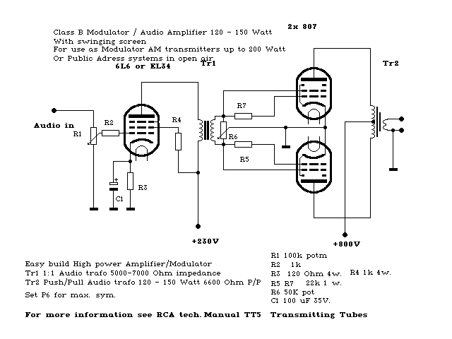

Vizitator Postat Iunie 25, 2019 Partajează Postat Iunie 25, 2019 Am deschis topicul pt ca am intervenit la problema cu lipsa sarcinii (sau sarcina foarte mica) unde am spus din burta ca la SE este o problema deoarece pt mine semana cu o sursa FLYBACK. Cautand diferite scheme cu lampi am vazut ca si la SE si la PP curentul este apropiat eu crezand ca este ca la tranzistoare fara traf, adica la PP curentul de repaus sa fie nesemnificativ fata de curentul max prin sarcina. Simuland cu MOS-uri am vazut ca difera de trafuri retea si SMPS. Nu stiu sa lucrez cu lampi in simulatoare asa ca am crezut ca imi explica cineva ca unui elev de liceu de ce in PP este nevoie de asa curent mare. Pana la urma o sa-l rog pe dl. Sabac sa ma ajute cu simularea cu lampi si poate aflu singur. As fi curios sa puna cineva si o schema clara de clasa B cu lampi, cu G. nu am gasit ceva multumitor. Link spre comentariu

adrian_pic Postat Iunie 25, 2019 Partajează Postat Iunie 25, 2019 (editat) Acum 49 minute, miticamy a spus: As fi curios sa puna cineva si o schema clara de clasa B cu lampi, cu G. nu am gasit ceva multumitor. O schema simpla : Citat The Class B amplifier is substantially biased to cut-off of plate current when no input signal voltage is applied so that plate current flows essentially over one-half the input voltage cycle. The operating angle of plate current flow is essentially 180 degrees. The Class B amplifier is almost always driven with a signal to the extent that grid current flows. Class B push-pull amplifiers are the most efficient tube type audio amplifiers. Full-signal plate-circuit efficiencies of 60% to 70% are readily available. Class B push-pull amplifiers must be carefully designed to minimize the crossover distortion as plate current flow switches from one tube to the other in the push-pull pair during the positive and negative cycles of the input signal. The most notable Class B guitar amplifiers are those made by Music Man. These employed a cathode driven circuit using driver transistors to provide the signal to the output tubes. These amplifiers have an output of 75 watts with two output tubes and 150 watts with four output tubes, where a Class AB amplifier would be rated at 50 watts for two output tubes and 100 watts when using the same type of tubes. Editat Iunie 25, 2019 de adrian_pic Link spre comentariu
Vizitator viobio Postat Iunie 25, 2019 Partajează Postat Iunie 25, 2019 (editat) Acum 51 minute, miticamy a spus: Am deschis topicul pt ca am intervenit la problema cu lipsa sarcinii (sau sarcina foarte mica) unde am spus din burta ca la SE este o problema deoarece pt mine semana cu o sursa FLYBACK. Cautand diferite scheme cu lampi am vazut ca si la SE si la PP curentul este apropiat eu crezand ca este ca la tranzistoare fara traf, adica la PP curentul de repaus sa fie nesemnificativ fata de curentul max prin sarcina. Simuland cu MOS-uri am vazut ca difera de trafuri retea si SMPS. Nu stiu sa lucrez cu lampi in simulatoare asa ca am crezut ca imi explica cineva ca unui elev de liceu de ce in PP este nevoie de asa curent mare. Pana la urma o sa-l rog pe dl. Sabac sa ma ajute cu simularea cu lampi si poate aflu singur. As fi curios sa puna cineva si o schema clara de clasa B cu lampi, cu G. nu am gasit ceva multumitor. Clasă B , schema si datele tubului . Zilele acestea lucrez la depanarea + uograde Jadis Orchestra Reference , are Ua 500V , Ia0 18..20mA , adică anodică mare curent de repaos mic . Clasele B lucrează pe Raa mare , peste 6k Editat Iunie 25, 2019 de viobio Link spre comentariu

Vizitator Postat Iunie 25, 2019 Partajează Postat Iunie 25, 2019 (editat) Acum 1 oră, Faust2018 a spus: Clasele B lucrează pe Raa mare , peste 6k Pentru un etaj final PP clasa-A dat cu o alimentare dată (menținem tensiunea de alimentare etaj final Ua) ce trebuie să modific astfel încât să trec etajul final în clasa B ?(evident micșorăm curentul ia_0/tub). Măresc sau micșorez sarcina anod-anod Raa ? ca să ajung în clasa B cu etajul final, să cresc eficiența la anozi. (poate răspunde oricine) Editat Iunie 25, 2019 de Vizitator Link spre comentariu
