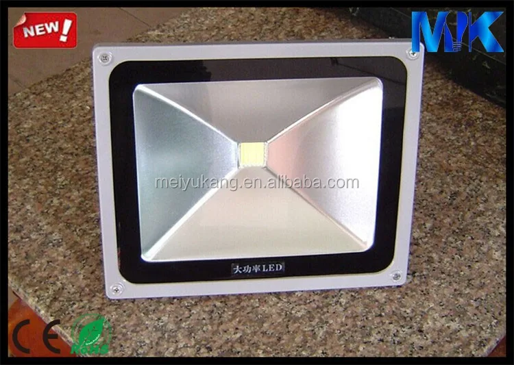

gabyh Postat Ianuarie 11, 2018 Partajează Postat Ianuarie 11, 2018 (editat) Prima data ar fi ok sa pui niste poze cu ce ai in el sa vedem ce tip de cob(chinezesc) era si ce driver e mai exact...chinezu le cam trage de par de multe ori driverul (sursa de cc) este la maximul cat suporta ledul si...mai ales ca acel led este pe un radiator(heatsink) prea mic pentru a disipa caldura generata de led ...care tip de proiector il ai ca sunt mai mai multe tipuri la 50w ca si carcasa...dar majoritatea sunt fie din zamac sau aliaje proaste de aluminiu sau antimoniu care nu fac o disipare ok a caldurii . Asa ceva ai? https://www.eledlights.com/media/catalog/product/cache/1/thumbnail/8e86a600b326f05ecba54a74871cbc49/7/0/70w_front_500x500_1.jpg http://www.asvestas.eu/wp-content/uploads/2013/09/DSC_0283.png http://www.snowdragonledhk.com/images/i200/id245/50w-led-flood-light-heat-sink-sd50a-11.jpg http://www.gigaled.gr/img/cms/10w-flood-light02final.png http://sc01.alicdn.com/kf/HTB16eOjHFXXXXaYXpXXq6xXFXXXh/Die-Cast-extruded-aluminum-heatsink-50w-led.jpg https://www.aliexpress.com/item/Newest-85-265V-LED-luminaire-light-IP65-50w-LED-Flood-Light-bulbs-Floodlight-LED-street-Lamp/32702622557.html ti-ar trebui asa ceva pe care sa montezi ledul https://sc01.alicdn.com/kf/HTB1QY.nj50TMKJjSZFN761_1FXaW/extrusion-aluminium-50w-led-cob-heatsink.png_220x220.jpg sau http://newimg.globalmarket.com/PicLib/495/2578495/prod/3d42cfb03630f97809c1a8937a482c6b_l.jpg sau daca ar incapea unu cu cooler ca asta https://ae01.alicdn.com/kf/HTB11K03SpXXXXXyaVXXq6xXFXXXH/Hot-20W-30W-50w-100w-high-power-led-heatsink-DC-12V-led-cooling-fan-led-high.jpg fara o ''aerisire'' cum trebuie la fel vei pati cu oricare singura varianta plauzibila ar fi sa gasesti un driver care, sa aiba un curent mai mic decat suporta ledul Ce scrie pe driver? cati mA are pe output? asa ceva? https://i.ebayimg.com/images/g/O9IAAOSwOVpXUrLa/s-l1600.jpg? sau asa? https://www.ebay.com/itm/High-Power-50W-watts-SMD-LED-Chip-Lamp-Beads-White-Red-Blue-Green-RGB-UV-Light-/122046189206 deci pune niste foto Apropo de spunea DXXX ca a scris in timp ce scriam si eu daca tot vrei sa schimbi cu o chinearie ..pune 1 de 100w cu driveru tau e la 50% avand curentul maxim suportat la 3000mA https://www.ebay.com/itm/10-20-30-50-100W-Waterproof-LED-Driver-Power-Supply-SMD-Chip-Bulb-For-Floodlight/162566658292?hash=item25d9ba58f4:m:mlNzJ-JQXWbxMxZXbAdYR7w Editat Ianuarie 11, 2018 de gabyh Link spre comentariu
