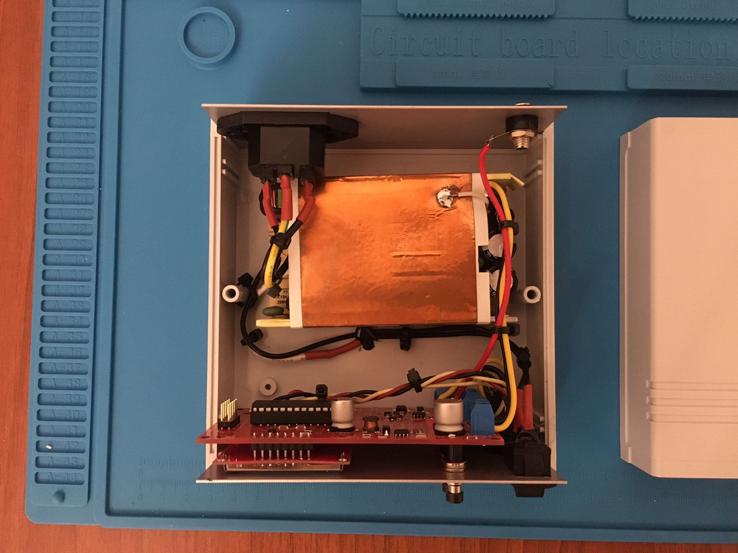

Mihai85 Postat Ianuarie 24, 2022 Partajează Postat Ianuarie 24, 2022 (editat) Am reusit sa o finalizez. https://i.postimg.cc/J0KyWnK3/Whats-App-Image-2022-01-24-at-19-48-01.jpg https://i.postimg.cc/MZYfBPxc/Whats-App-Image-2022-01-24-at-19-48-01-1.jpg https://i.postimg.cc/BbJ8yD5Q/Whats-App-Image-2022-01-24-at-19-48-02.jpg https://i.postimg.cc/j5HwZv7F/Whats-App-Image-2022-01-24-at-19-48-09.jpg https://i.postimg.cc/zBZHC4Vh/Whats-App-Image-2022-01-24-at-20-16-48.jpg https://i.postimg.cc/N0rrrQfY/Whats-App-Image-2022-01-24-at-20-16-48-1.jpg https://i.postimg.cc/SxPMsn4D/Whats-App-Image-2022-01-24-at-20-16-48-2.jpg https://imgur.com/a/ib7pr0r Editat Ianuarie 24, 2022 de Mihai85 Link spre comentariu

Geza Postat Ianuarie 24, 2022 Partajează Postat Ianuarie 24, 2022 Arata bine. Ma gandeam ca e taiat cu cnc ca arata perfect, eu m-am gandit sa fac cu un traf toroidal si punte. Mie maine, poimaine imi ajunge, deocamdata culeg informatii referitor la ea. Link spre comentariu

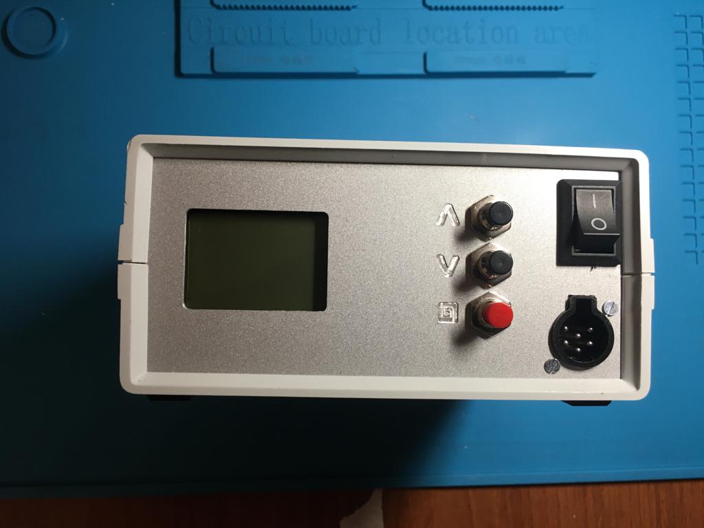

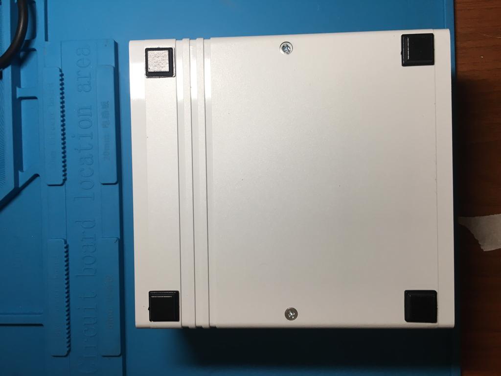

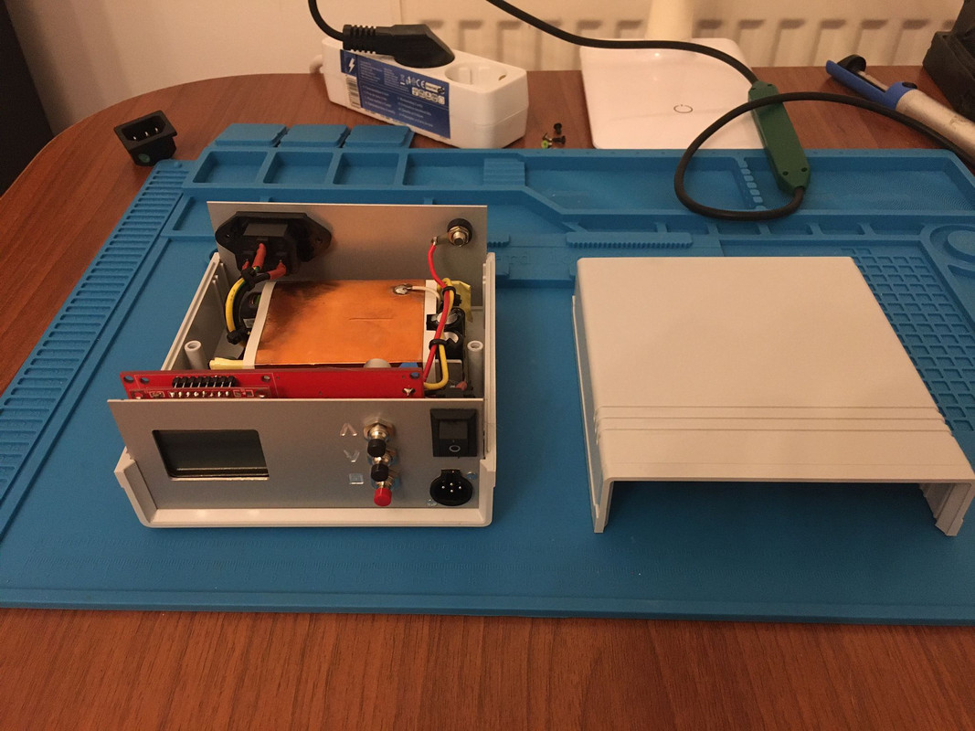

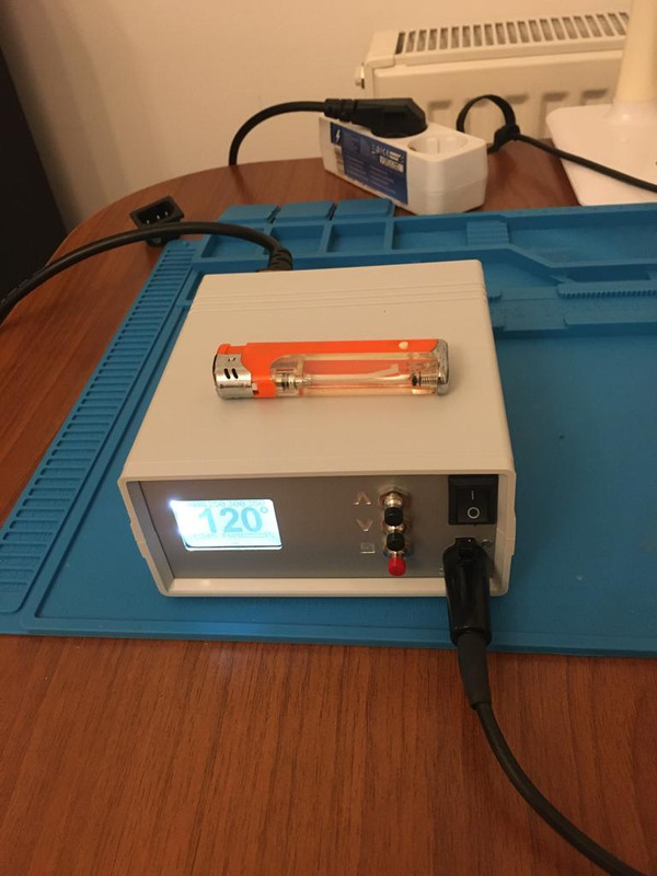

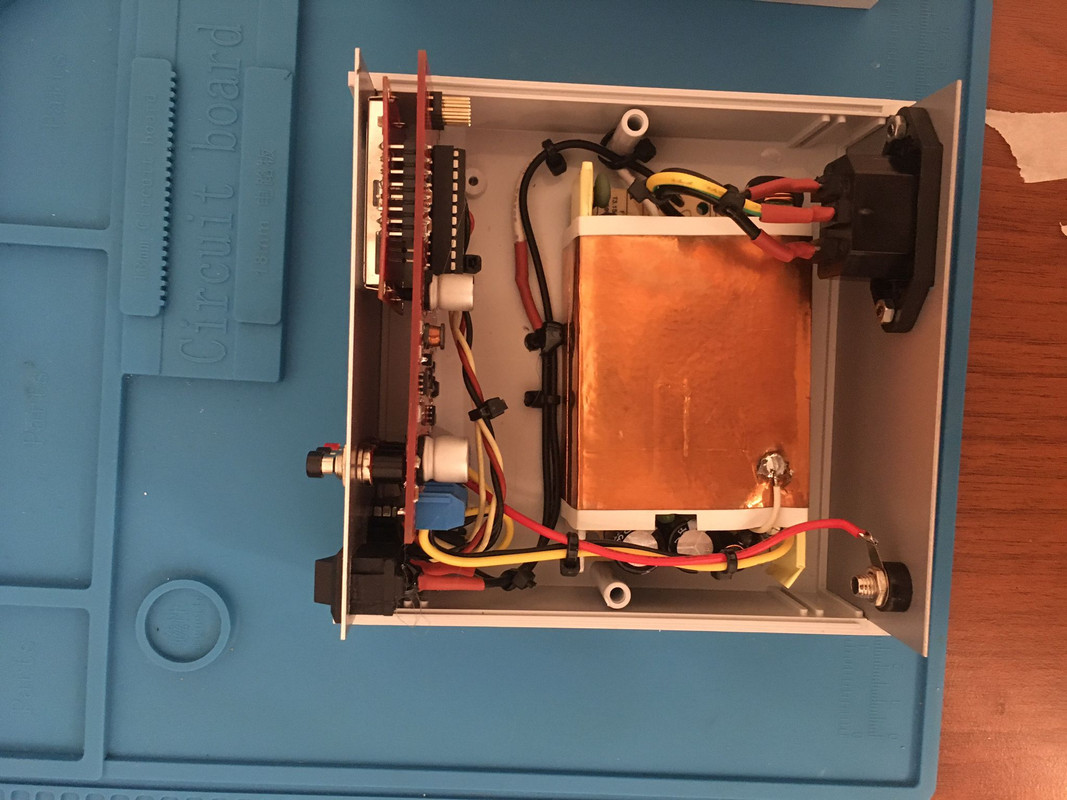

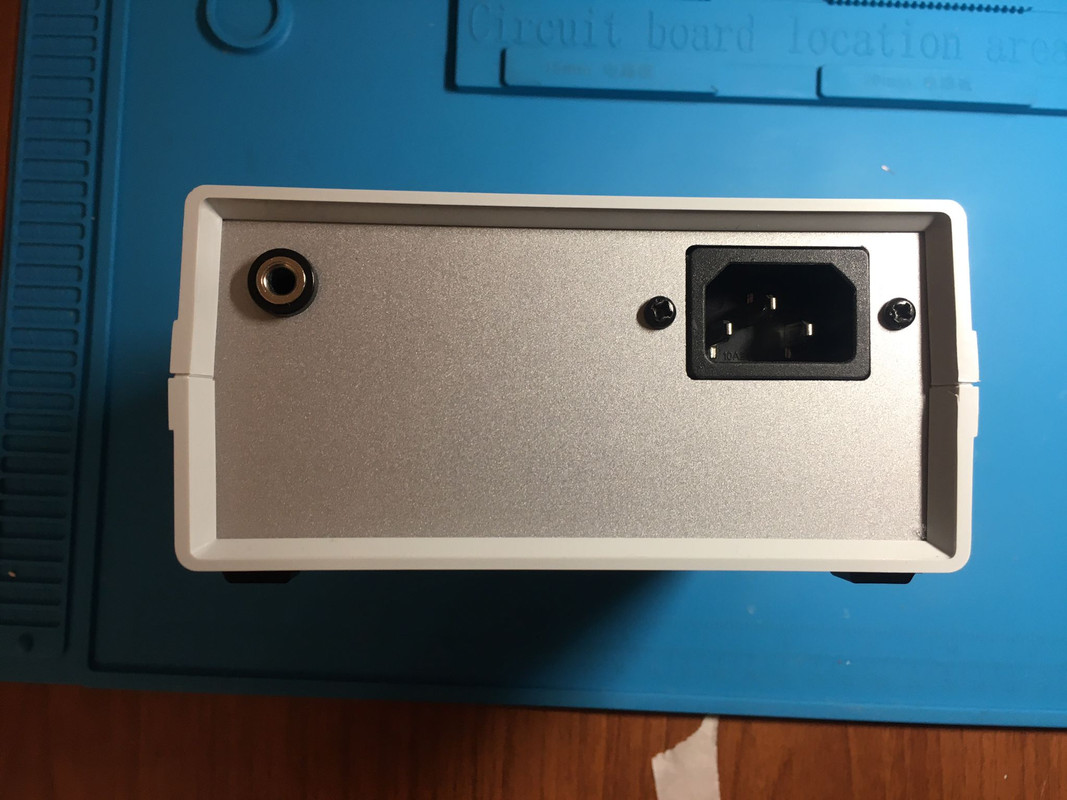

Geza Postat Februarie 10, 2022 Partajează Postat Februarie 10, 2022 (editat) Am finalizat si eu kitul de jbc. Functioneaza foarte bine. Multumesc @djvas cateva poze: https://postimg.cc/gallery/1zhrx8W [url=https://postimg.cc/N9cLFzLp][img]https://i.postimg.cc/N9cLFzLp/1.jpg[/img][/url] [url=https://postimg.cc/PPRxYxPL][img]https://i.postimg.cc/PPRxYxPL/2.jpg[/img][/url] [url=https://postimg.cc/CdvLp1Cv][img]https://i.postimg.cc/CdvLp1Cv/3.jpg[/img][/url] [url=https://postimg.cc/1f2m4jjw][img]https://i.postimg.cc/1f2m4jjw/4.jpg[/img][/url] [url=https://postimg.cc/mzjZDZvg][img]https://i.postimg.cc/mzjZDZvg/5.jpg[/img][/url] [url=https://postimg.cc/943QgnPC][img]https://i.postimg.cc/943QgnPC/6.jpg[/img][/url] [url=https://postimg.cc/xcC8XHTD][img]https://i.postimg.cc/xcC8XHTD/7.jpg[/img][/url] Editat Februarie 10, 2022 de Geza Link spre comentariu

Geza Postat Februarie 11, 2022 Partajează Postat Februarie 11, 2022 Multumesc. Eu am cumparat cu 16 lei carcasa ( se gasesc la magazine cu electronice si la tor parca am vazut) pt imprimarea cu plus, minus, menu am platit 100 lei la o firma cu reclame, toroidalul de 12v 11A a fost 200 lei, puntea 25, intrerupatoarele si butoanele, aprox. 50 lei, plus letcon, varf si mufa Link spre comentariu
Mihai85 Postat Februarie 12, 2022 Partajează Postat Februarie 12, 2022 Felicitari pt realizare!De ce nu ati folosit o sursa in comutatie? Merg foarte bine alimentatoarele (originale) de laptop. Pentru asta a fost proiectata in special varianta in cc. Link spre comentariu
Geza Postat Februarie 12, 2022 Partajează Postat Februarie 12, 2022 Multumesc! Initial am vrut sa fac cu alimentator de laptop. De aceea am facut gaura pt intrerupatorul negru. Nu am gasit alimentator doar de 4A, si am citit ca trebuia macar de 8A. Plus ca am vazut ca un coleg a facut cu toroidal si mi a spus ca merge foarte bine. De aceea am optat pt asta. Link spre comentariu
Mery4 Postat Februarie 13, 2022 Partajează Postat Februarie 13, 2022 On 2/11/2022 at 7:35 PM, Geza said: Multumesc. Eu am cumparat cu 16 lei carcasa ( se gasesc la magazine cu electronice si la tor parca am vazut) pt imprimarea cu plus, minus, menu am platit 100 lei la o firma cu reclame, toroidalul de 12v 11A a fost 200 lei, puntea 25, intrerupatoarele si butoanele, aprox. 50 lei, plus letcon, varf si mufa Am inteles. Eu sper sa reusesc sa ajung la mai putin, si asa am depasit bugetul pentru statie doar cu letconul, pcb si mufa. Voi incerca sa folosesc un incarcator de laptop, iar carcasa sper sa fie ok printata. Link spre comentariu
BRANCA Postat Februarie 13, 2022 Partajează Postat Februarie 13, 2022 Clona aia JBC,din Chima,parcâ era la max 130-150$.Nu iese mai ieftin ca una făcută în regim propriu?Sau,mă rog,pe aproape de costul uneia diy...După prezentările pe youtube ar fi şi performantă... Link spre comentariu
XAN77 Postat Februarie 13, 2022 Autor Partajează Postat Februarie 13, 2022 Acum 17 ore, Geza a spus: Multumesc! Initial am vrut sa fac cu alimentator de laptop. De aceea am facut gaura pt intrerupatorul negru. Nu am gasit alimentator doar de 4A, si am citit ca trebuia macar de 8A. Plus ca am vazut ca un coleg a facut cu toroidal si mi a spus ca merge foarte bine. De aceea am optat pt asta. Nu-ți trebuie de 8A, numărul de amperi influențează viteza de încălzire mai ales când pleacă de la rece. Eu am testat cu sursă de sub 5A când am dezvoltat prima dată varianta CC și se încălzea destul de rapid. În plus ai un fel de protecție a vârfurilor cu rezistență mică, deși poate e doar părerea mea că unii vor spune că sursa poate da pe timp scurt putere mult mai mare. Link spre comentariu
hixpp02 Postat Februarie 13, 2022 Partajează Postat Februarie 13, 2022 Eu am pus o sursa de 6,3A și se comporta foarte bine. Link spre comentariu
Mihai85 Postat Februarie 13, 2022 Partajează Postat Februarie 13, 2022 La mine merge cu 5A. Oricum alimentatoarele suporta si niste varfuri de curent mai mare ceea ce e acoperitor. Link spre comentariu
Geza Postat Februarie 13, 2022 Partajează Postat Februarie 13, 2022 "Incarcator de laptop este bun dar sa gasiti unul de minim 8A pentru ca altfel exista posibilitatea sa l bage in protectie" Asta mi a zis colegul djvas (de la el am cumparat) cand discutam de sursa de laptop. Link spre comentariu
